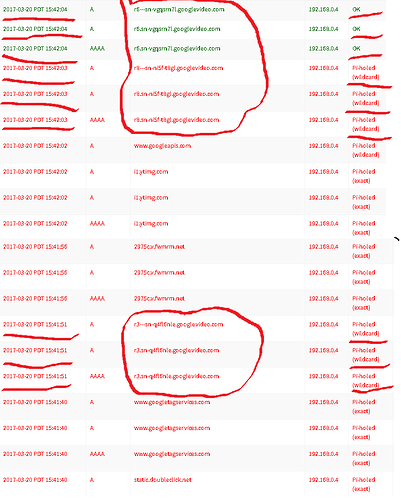

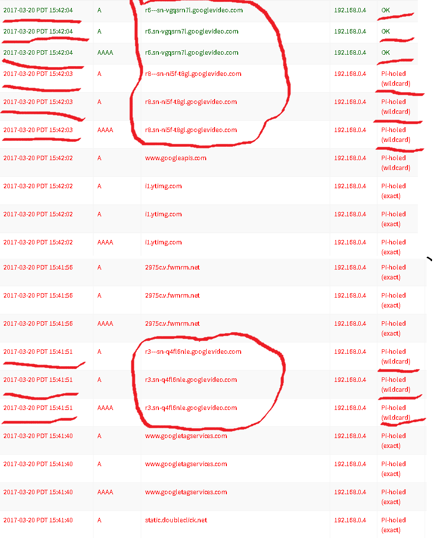

Hey so I have noticed that many of the domains that google uses for their ads are very similar except for the first section. See these examples that I pulled from ads that came up on youtube:
r4---sn-ni5f-t8gl
r7---sn-ni5f-t8gl
r3---sn-ni5f-t8ge
r2---sn-ni5f-t8ge
r1---sn-ni5f-t8ge
I would block one exactly like so: "r4---sn-ni5f-t8gl.googlevideo.com" only to have the same ad show up later with this domain: "r7---sn-ni5f-t8gl.googlevideo.com".
Seeing this pattern I decided to try using a wildcard like so: "sn-ni5f-t8gl.googlevideo.com" and it seems to have worked quite well. Currently I am only using these blacklisted wildcard domains to block youtube ads. I deactivated the adlist that was posted here just to verify and it still works quite well. I think that if this doesn't end up causing problems with desired video content then it could be a porwerful tool to help us weed out these ads.
let me know what you guys think.
Edit: nevermind, ads still load...
Might have had a bit of a breakthrough here. check out this Reddit thread.
They have a list of domains, some of which aren't on any adlists that I have been using.
Using this list (minus the www.youtube.com/api/ entry cause that blocks access to the site entirely) in addition to the googlevideo.com entries we have collected I have had a much greater success rate in blocking ads.
It seems that google has a way of detecting when a specific googlevideo.com domain doesn't load and then tries to load an alternate. I noticed that an ad wouldn't load for 3-5 seconds like it does when it's blocked, but then the ad would play anyways after that pause. looking in the Query section of the ad console i could see it trying to load different domains before it found one that went through successfully as seen here:
This needs more testing and I'm but a simple truck driver. I'm sure you guys would be able to use this info in a better way than I can.
Good luck and thanks for all the hard work!
