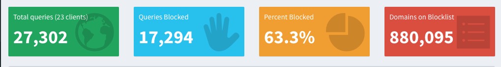

What is the output of the following commands to see how Pi-Hole is handling a known ad-serving domain?
dig flurry.com
dig flurry.com @8.8.8.8
And, can you upload a screen capture of this part of your dashboard?
