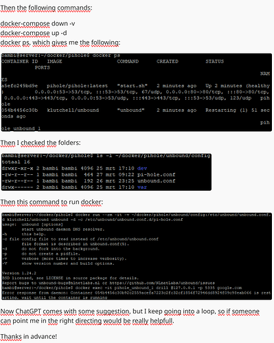

Hi everyone,
I’m trying to run Pi-hole + Unbound in Docker on my server, with the help of Chatgpt, but I keep running into issues with Unbound. Pi-hole works fine, but Unbound keeps crashing with this error:
/unbound.sh: line 36: /opt/unbound/etc/unbound/unbound.conf: Is a directory
input in flex scanner failed
unbound exited with code 2
My setup:
  • OS: Debian 12 bookworm server
  • Docker version: latest
  • Pi-hole + Unbound running via Docker Compose

What I’ve tried so far:
  • Verified unbound.conf is a file and not a directory
  • Placed unbound.conf inside a config directory
  • Ran docker-compose down -v and docker-compose up -d
  • Checked the file inside the container using:
    docker run -it --rm -v ~/docker/unbound/config:/opt/unbound/etc/unbound mvance/unbound:latest sh
    The unbound.conf file is visible inside /opt/unbound/etc/unbound
Problem:
Unbound still fails with the message that unbound.conf is a directory, even though the file exists in the config folder. I suspect something is wrong with the Docker volume mounting.
Has anyone successfully run Unbound in Docker with Pi-hole as upstream DNS? How should I configure the volumes and paths so that Unbound starts correctly?
Thanks in advance!

I switched from mvance/unbound to klutchell/unbound as suggested and updated my docker-compose.yml to use the newer Pi-hole v6 environment variables (FTLCONF_*).
At this point:
  • Pi-hole starts correctly (still in “health: starting”, but no crashes)
  • Unbound no longer shows the “unbound.conf is a directory” error
  • My unbound.conf validates and runs fine when I start it manually inside a container (unbound -d -c ...)

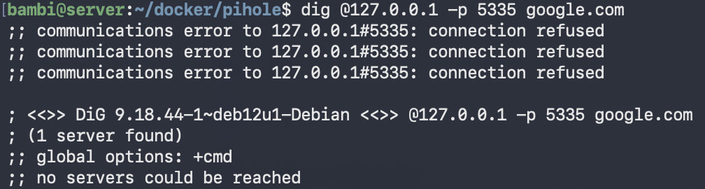

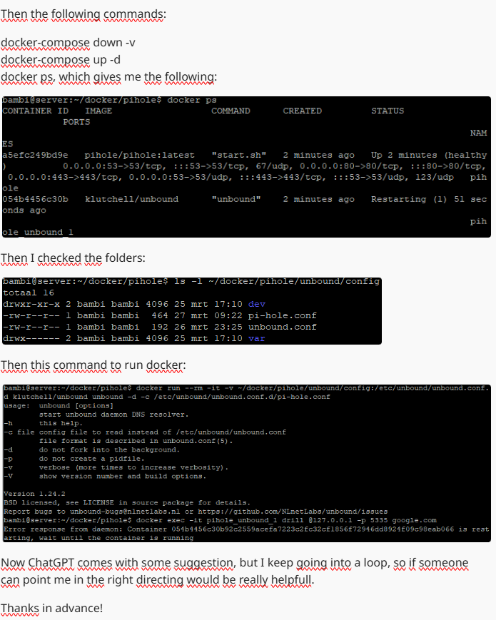

However, I’m still running into an issue where the Unbound container keeps restarting:
unbound   Restarting
And DNS queries fail:
dig @127.0.0.1 -p 5335 google.com
I’ve verified the following:
  • unbound.conf is a file (not a directory)
  • File permissions are correct (readable)
  • Paths in docker-compose.yml are correct (../unbound/...)
  • Unbound runs fine manually in a test container with the same config
So it seems like:
:backhand_index_pointing_right: The config itself is valid
:backhand_index_pointing_right: But something in the container startup is still causing it to exit
At this point I suspect either:
  • an issue with how the container is started (command / entrypoint), or
  • a mismatch between expected paths inside the image
Does anyone see something obvious I’m missing in this setup?
Thanks in advance!

At this point, the main issue seems to be that the Unbound container is stuck in a restart loop. It never stays up long enough to accept connections, which explains why queries to 127.0.0.1:5335 fail with “connection refused”.
From the logs, I only see the generic Unbound usage output, which suggests that it is not successfully loading the configuration file.
Earlier, I also ran into an issue where unbound.conf was accidentally created as a directory instead of a file. I have since removed that and recreated it as a proper file, so that specific issue should be resolved now.

You likely see that message as there is nothing listening on port 5335, which seems correct with your current configuration:
The above compose doesn't expose any ports for its unbound container - it is meant to be accessible only to containers on the same network, i.e. from the pihole container on the same default brigde network.

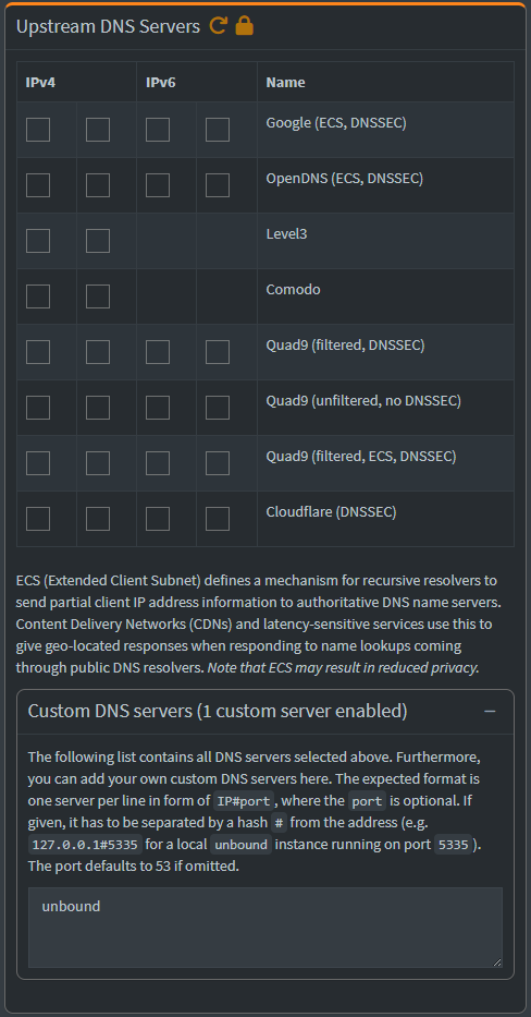

Now in my Pihole webinterface, how can I check unbound is my DNS?
This is what I have in DNS settings, but can’t be edited:

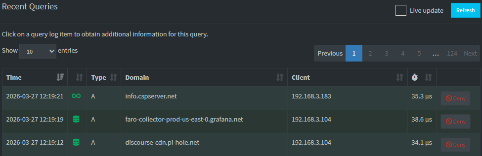

In the querry log I should see unbound as client right? But I don’t:
At the moment Pihole only blocks about 21%, that is not a lot (I have 5 lists) but maybe normal?
It's correctly showing unbound as Pi-hole's sole upstream, as custom DNS server.
Note that any option that you control via your Pi-hole container's environment variables will become read-only in Pi-hole's UI.
Accordingly, you'd need to edit your docker compose file if you'd want to change such an option's value.
No, unbound is your Pi-hole's upstream.
Your DNS resolution chain looks like this:
client :right_arrow: Pi-hole :right_arrow: unbound :right_arrow: public authoritative DNS servers.
That is a statistical figure, not an indicator of blocking quality.
It can be expected to fluctuate over time, even wildly, according to the domains your clients try to connect to.
If you had only a single client spending time on Pi-hole's forum, your blocking rate would be close to 0%.
And at 100% blocking rate, you wouldn't be able to connect to anything. :wink:
