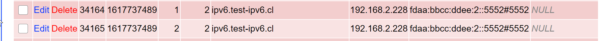

the database says:
e.g. first an A query, then an AAAA query

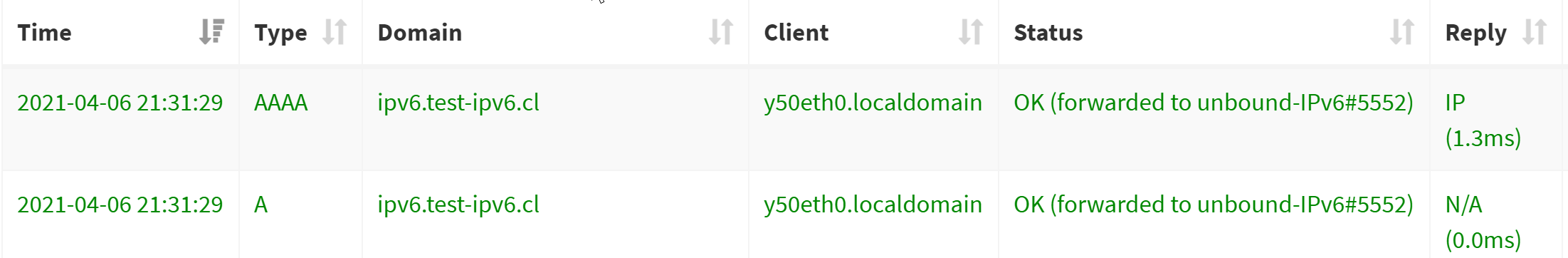

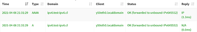

the query log says (Reply N/A 0.0ms) for the A query:
missing a reply for the A query or just cosmetic?
Lots of N/A entries in the query log, using the test site ...
The retries in the query log, which could also be found in the database (status 12), are now N/A in the query log, but the database doesn't show anything (abnormal), that allows you to find these entries, using select, thus cosmetic?
edit
dig A ipv6.test-ipv6.cl doesn't return an IPv4 address
dig AAAA ipv6.test-ipv6.cl does return IPv6 2001:1398:1:0:200:1:122:49
does N/A always mean no result? Is there a status that would reflect "No result" other than N/A, with no matching value in the database?
/edit
Simon eventually agreed on my patch being useful, he just stripped the customizability of the timeout value and hard-coded it to 2 seconds. Update pushed.
It means no result received at all from upstream (so we don't know if NOERROR, NODATA, NXDOMAIN), etc. It is perfectly normal when restarting as the reply type nor the response time are stored in the database to avoid blowing the database file (further) up.

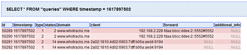

some results in a PM, but a think (hope) I found a reason why...
remember (previous discussions) , I'm on windows 10 20H2, with IPv4 (fixed address) and IPv6 (temporary IPv6 address, default out of the MS box). The IPv6 address changes every day, or after a reboot/restart. The fact the IPv6 address changes isn't really a problem, the fact that the windows 10 system has both IPv4 and IPv6 (GUA) appears to be a problem (I think).
Look at this very short list of queries, registered in the pihole.log today.
cat /var/log/pihole/pihole.log | grep www.whotracks.me
Apr  8 17:58:22 dnsmasq[18854]: 14786 192.168.2.228/60196 query[A] www.whotracks.me from 192.168.2.228
Apr  8 17:58:22 dnsmasq[18854]: 14786 192.168.2.228/60196 forwarded www.whotracks.me to fdaa:bbcc:ddee:2::5552
Apr  8 17:58:22 dnsmasq[18854]: 14787 192.168.2.228/59656 query[AAAA] www.whotracks.me from 192.168.2.228
Apr  8 17:58:22 dnsmasq[18854]: 14787 192.168.2.228/59656 forwarded www.whotracks.me to fdaa:bbcc:ddee:2::5552
Apr  8 17:58:22 dnsmasq[18854]: 14788 2a02:1810:4d02:6903:7dff:b06a:aed4:9194/59656 query[AAAA] www.whotracks.me from 2a02:1810:4d02:6903:7dff:b06a:aed4:9194
Apr  8 17:58:22 dnsmasq[18854]: 14789 2a02:1810:4d02:6903:7dff:b06a:aed4:9194/60196 query[A] www.whotracks.me from 2a02:1810:4d02:6903:7dff:b06a:aed4:9194
Apr  8 17:58:22 dnsmasq[18854]: 14786 192.168.2.228/60196 reply www.whotracks.me is 13.226.159.6
Apr  8 17:58:22 dnsmasq[18854]: 14786 192.168.2.228/60196 reply www.whotracks.me is 13.226.159.11
Apr  8 17:58:22 dnsmasq[18854]: 14786 192.168.2.228/60196 reply www.whotracks.me is 13.226.159.31
Apr  8 17:58:22 dnsmasq[18854]: 14786 192.168.2.228/60196 reply www.whotracks.me is 13.226.159.75
Apr  8 17:58:22 dnsmasq[18854]: 14787 192.168.2.228/59656 reply www.whotracks.me is 2600:9000:21d7:200:10:8b76:f140:93a1
Apr  8 17:58:22 dnsmasq[18854]: 14787 192.168.2.228/59656 reply www.whotracks.me is 2600:9000:21d7:9800:10:8b76:f140:93a1
Apr  8 17:58:22 dnsmasq[18854]: 14787 192.168.2.228/59656 reply www.whotracks.me is 2600:9000:21d7:2c00:10:8b76:f140:93a1
Apr  8 17:58:22 dnsmasq[18854]: 14787 192.168.2.228/59656 reply www.whotracks.me is 2600:9000:21d7:6000:10:8b76:f140:93a1
Apr  8 17:58:22 dnsmasq[18854]: 14787 192.168.2.228/59656 reply www.whotracks.me is 2600:9000:21d7:3600:10:8b76:f140:93a1
Apr  8 17:58:22 dnsmasq[18854]: 14787 192.168.2.228/59656 reply www.whotracks.me is 2600:9000:21d7:8c00:10:8b76:f140:93a1
Apr  8 17:58:22 dnsmasq[18854]: 14787 192.168.2.228/59656 reply www.whotracks.me is 2600:9000:21d7:a600:10:8b76:f140:93a1
Apr  8 17:58:22 dnsmasq[18854]: 14787 192.168.2.228/59656 reply www.whotracks.me is 2600:9000:21d7:b800:10:8b76:f140:93a1
The system does a A and AAAA query (first four (4) lines), using the IPv4 address, these are forwarded.
Than, the next two (2) lines, there is an A and AAAA, using the IPv6 address, apparently NOT forwarded, but using the same source port as the IPv4 queries did
The database entries:
If I read everything correct in the dnsmasq discussion group, the source port match causes dnsmasq to mark them as retries.
If my analysis is correct (NOT sure) this might be a windows problem, I have NO idea how to fix this...
I hope another windows 10 user reads this, perform the same tests, and hopefully confirm my diagnose...
No, because
The port doesn't matter at all and we don't know if it had the same ID but we know for sure the it is not the same IP address for the client (IPv4 vs. IPv6) --> it is a repeated query, not a retry in which case the behavior of dnsmasq/pihole-FTL is correct and my patch sent to Simon is actually saving you a whole lot of traffic. Much more than I assumed.
And your analysis is spot on: It is a Windows issue here. It should not send the same queries once per IPv4 and once per IPv6. This is needlessly doubled traffic. If you'd have only this one client (and it always behaves this way) you'd have 50% of all queries being unnecessary because IPv4 queries are in no way better than IPv6 queries (or vice versa).
A lot of internet docs say windows (and most other operating systems) prefer IPv6 over IPv4, yet, when looking at the pihole log, most of the DNS queries from this machine are IPv4 queries, only some, like the above example, do IPv4, immediately followed by an IPv6 queries.
The iPv4 DNS server is learned from the IPv4 DHCP server (e.g. the pihole IPv4 address), The IPv6 DNS server address is learned, using discovery. This IPv6 address is configured statically on the pfsense box (ends up in resolv.conf of the pfsense box), as soon as the client gets the IPv6 address (NOT a DHCP server, but the track interface option from pfsense), it also picks up the IPv6 DNS server address, using discovery.
