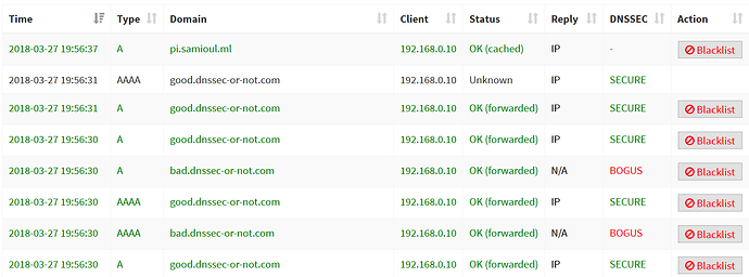

So far the beta version works fine on my Pi.
It even solves the bug between dnsmasq < 2.78 and DNScrypt-proxy (see here), so I can use FTLDNS with DNSSec enabled on Pi side (which is not possible with the "master" branch), perfect !
