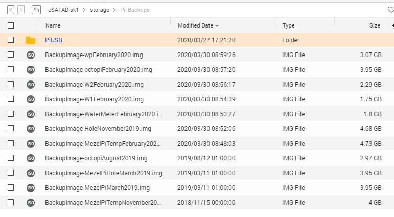

What I do is I make a 1:1 block copy of my pihole base once it is setup. This way if anything was to happen to my Pi (SDcard) I can simply write the full image back to any SD card of my choosing (the size of the block copy) and be back up and running.
I use Win32 disk imager and keep the image in a safe place.

If only I could get my images sizes as small as you have them!
