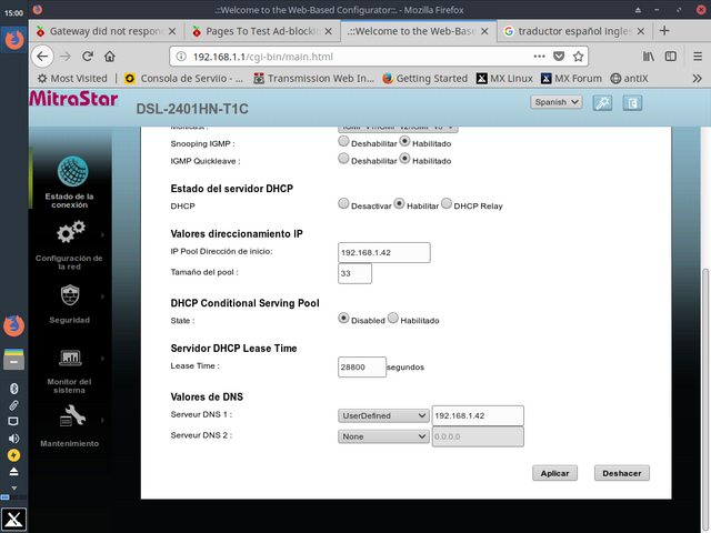

Did you set Pi-hole as your only DNS server in your router?

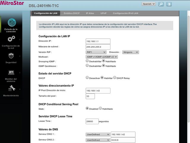

Yes. My raspberry with pihole is connected by wifi to a static address (192.168 ....) In the router, LAN section, like this
You are using more than just Pi-hole for DNS, so you will get DNS results from more than just Pi-hole, and some ads won't be blocked. Only use Pi-hole for DNS so that all ads are blocked.
Place only one, and I still see advertising
Check what DNS servers your clients are actually using.

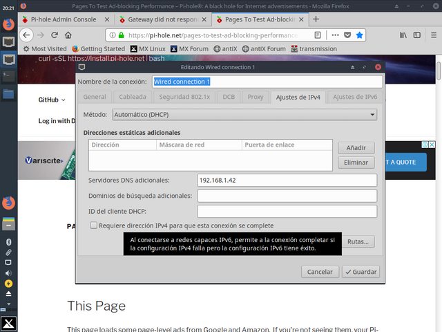

127.0.0.1 is the actually dns i am using
It does not work. I do not know what I'm doing wrong, but I lost all my Sunday trying to make this work ....
Is that the DNS server that the client is using, or just Pi-hole?

DNS client is 127.0.0.1
How I see the DNS client?
What clients do you have? Windows, linux, etc? Google "Find DNS on BLANK" where "BLANK" is the operating system the client is running.
