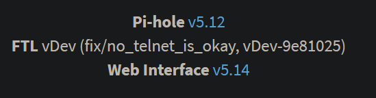

Confirming I was having the same issue, and this branch fixed the issue.

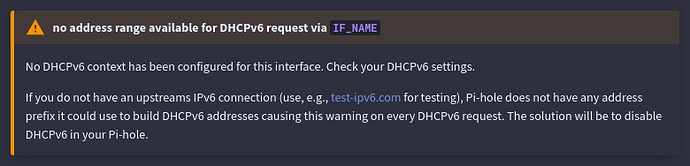

Would this fix be related to resolving my problem of my log constantly blowing up with the following?
Warning in dnsmasq core:
no address range available for DHCPv6 request via wlan0
PiHole points me to your documentation which does not cover the above warning. I've been trying to figure this out for weeks and I'm absolutely dumbfounded and frustrated by it.
I've had a similar experience as OP: I've been using PiHole for about a year for site-blocking and DNS capabilities, has been buttery smooth for me until the past few weeks when a pihole -up started spiking my logs with this same redundant error until my DNS server eventually crashes, the dashboard flips to showing NaN everywhere, and I'm required reboot the device.

pihole checkout ftl master
@bdrelling What you are describing is an altogether different issue and comes from the embedded dnsmasq
It does, almost at the bottom of the page:
Got it, thank you for the link. I looked at every single one of these that seemed similar and thought mine was specific to wlan0. I've previously tried going through every topic I can find related to no address range and DHCPv6 and nothing has resolved my problem. This issue came out of nowhere a few weeks ago after a pihole -up and my DNS seems to crash every few days, and I haven't changed my configuration in any way since I set the whole thing up.

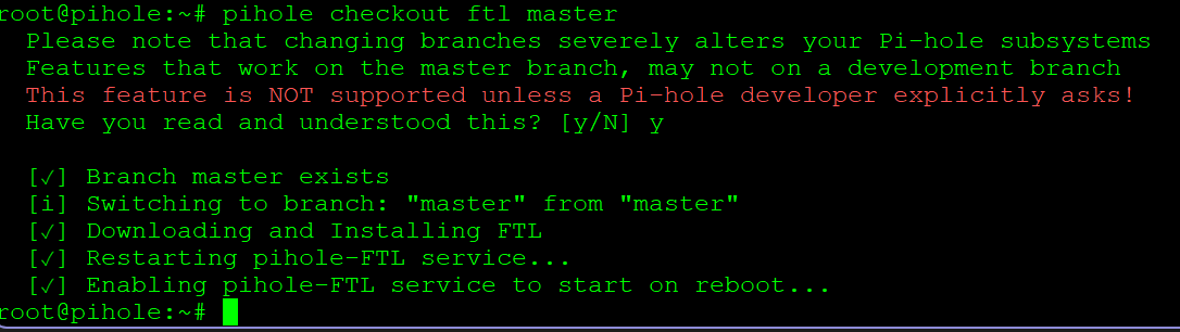

Thanks for all the swift testing + confirmation! The next version of FTL has been released including the fix for this issue. Please update and run
pihole checkout master
to get back on-track if you used my command above. The fix/feature branch you switched to will not receive any further updates.

So, silly question. If you checked out this FTL dev version to get things running again, what's the procedure to get things back to the main "official" version again?
Well, that didn't seem to do it? I rebooted the box and all that.
What is the output from this command:
