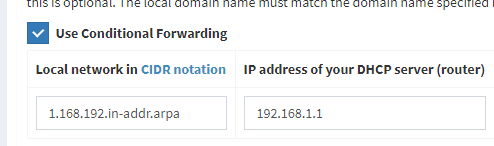

That said, I just checked my pi, and that was into the CF section:
I can tell you that I doubt I've had entered 1.168.192.in-addr.arpa... So I guess this comes from a recent update. In any case, the solution is quite clear, CIDR notation!
