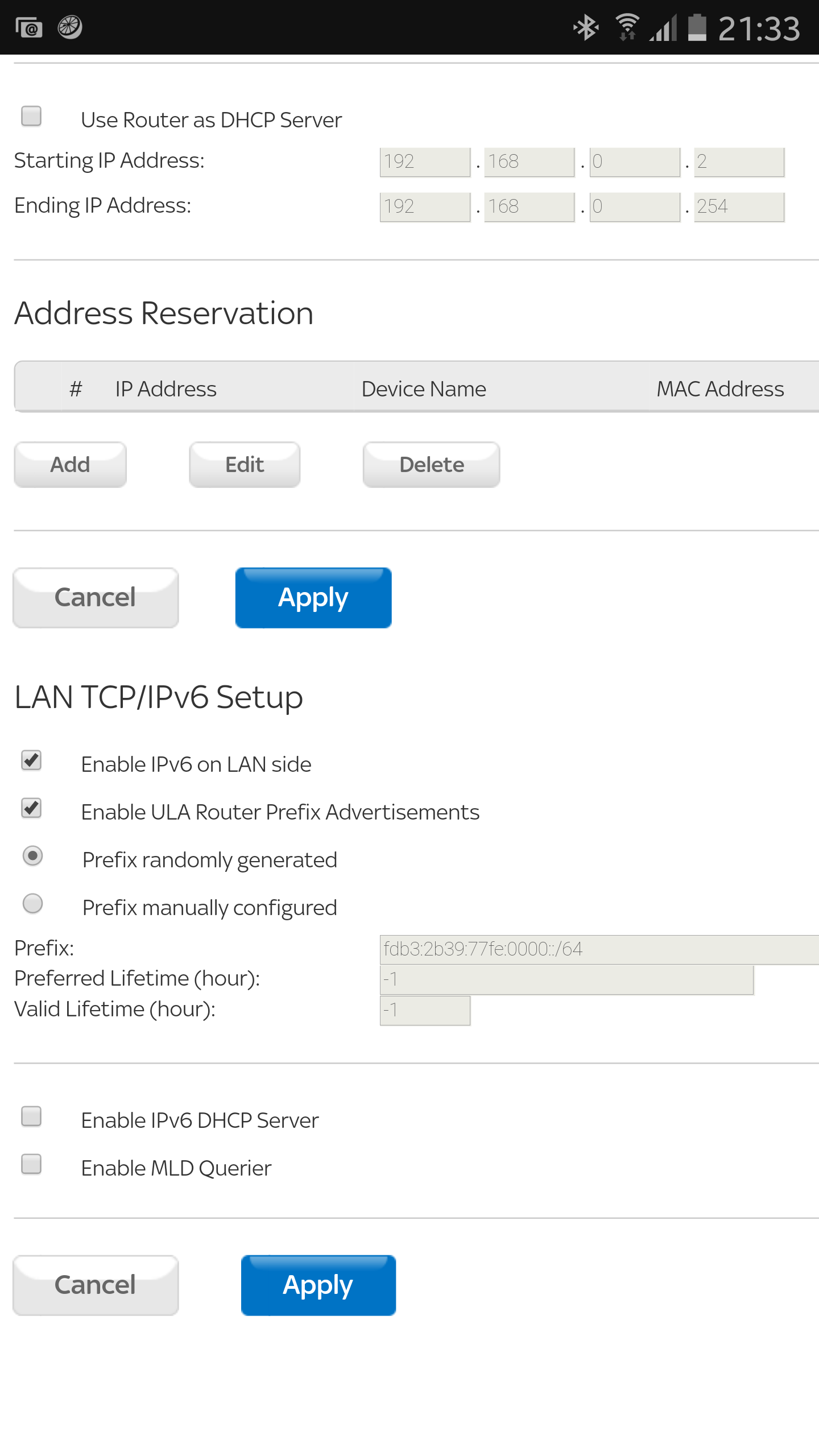

Within​Android settings, it tells me I have| 6 IP addresses?
1 ipv4
And 1 ipv6
The IPV6 address reported by android terminal matches what I see in my router settings under LAN port > IPV6 ULA, if that means anything.
Is there an option to disable IPv6 DHCP in the router? It sounds like that is still active.
I have it disabled...I think

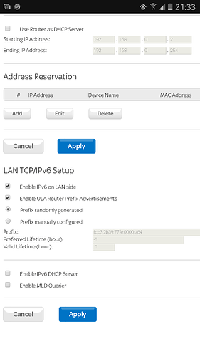

Not sure what the options under LAN TCP/IPv6 Setup are?
Your settings are to use IPv6 in your network and distribute ULA information using Router Advertisement packets. So far so good. I'm not sure how much you are aware about the internals of IPv6 as it is not very similar to IPv4 in some aspects.
E.g., IPv6 does not need a DHCP server (and, in fact, many operating systems do not even support IPv6 DHCP servers) as IPv6 has been designed to work without a central management. The auto-config mode of IPv6 works approximately as follows:
  1. The router advertises itself as the route to the public Internet and announces the public Internet prefix it has been addressed with. This information is contained in RA packets which are send in your internal network in frequent intervals. Usually, the information of usable DNS servers is enclosed in the RA packets
  2. Once a computer is attached to this network, it waits (or asks) for such a RA packet
  3. After receiving a RA packet it takes the transmitted prefix and builds an IPv6 address by itself (usually using the MAC address of the networking interface)
  4. Thereafter, it sends a packet to the network to check if there is any other device which is already having the same address (this is unlikely as the MAC address should be unique)
  5. If no other device is using this address, the new computer finishes the IPv6 configuration successfully
As you can see, there might still be DNS information delivered to your device and your router may not allow you to configure this.
Honestly, it both saddens and baffles me that many many router manufacturers seem unable to produce good IPv6 settings web interfaces as I haven't seen meaningful interfaces in a lot of routers out there...

The option in my router settings Enable IPV6 on LAN side....should this be checked or unchecked? Im not sure what this actually does?
Im starting to think this is being restricted via my isp provided router?

This connects that what I said above: I tend to agree. My ISP router is only submitting the IPv6 prefixes and leaves the clients alone with any DNS information altogether, i.e. if there would be no DNS information delivered over IPv4, then my clients wouldn't have any Internet at all!
I assume your router is "nice" enough to distribute some DNS information to your clients. But as you cannot switch this off/change what DNS servers are advertised, it is causing problems for you.
Unfortunately, this is to be expected as it points to the fact that your device just decides to use the IPv6 DNS server. One test: Please add an invalid IP address for the DNS server in your manual IPv4 configuration. What happens?

this time i unchecked the setting Enable IPv6 on LAN side in my router settings....ADVERTS ARE NOW BLOCKED ON ANDROID! :grimacing:
No idea what the setting does, but im going to leave it and see if i see any negative effects within my network
