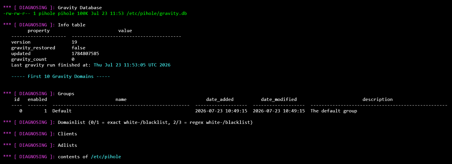

Any way, your debug log shows your gravity database is completely empty:
Please try this command to completely destroy and recreate the database:
sudo pihole -g -r recreate
