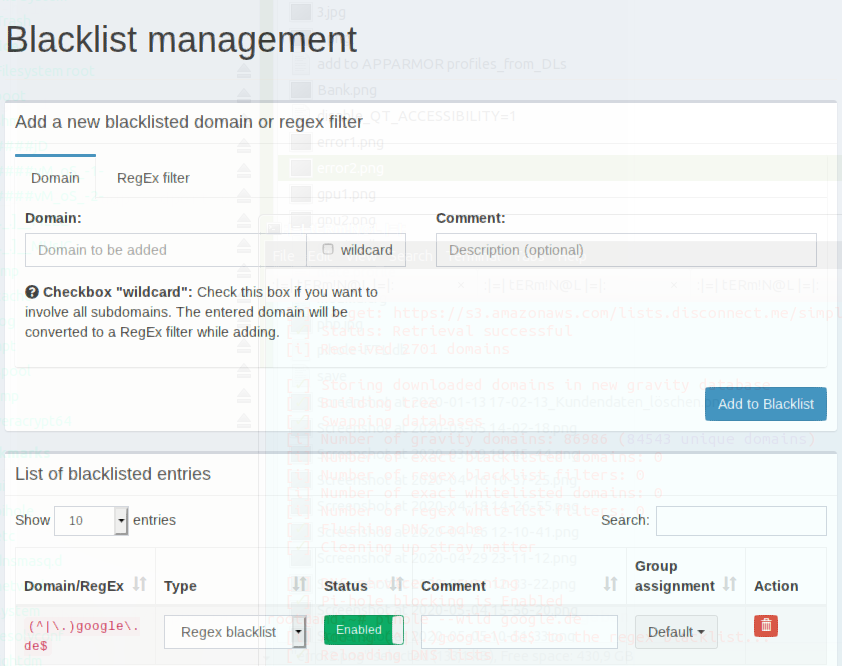

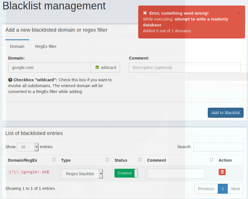

2020-05-29 16:25:35: (mod_fastcgi.c.421) FastCGI-stderr: PHP Warning: SQLite3Stmt::execute(): Unable to execute statement: attempt to write a readonly database in /var/www/html/admin/scripts/pi-hole/php/groups.php on line 507
As you can see:
via Terminal:
pihole --wild google.de
[i] Adding (^|.)google.de$ to the regex blacklist...
[✓] Reloading DNS lists

over Pi-Hole admin-panel in my webbrowser:
(tried out also 2 other webbrowser, same there)
Ubuntu 19.04 is running.
Pi-Hole is running on my local PC because I don't have a Pi.
Since I've been using Pi-Hole V5 it's been causing trouble with the database.
Seems that this problem has/had other users here in the forum.
If this problem cannot be solved then
it would be good if you can also control the Pi-Hole database via terminal. Import of complete Blacklist, Adlist etc.
With Pi-Hole V4 this problem did not exist.

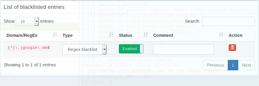

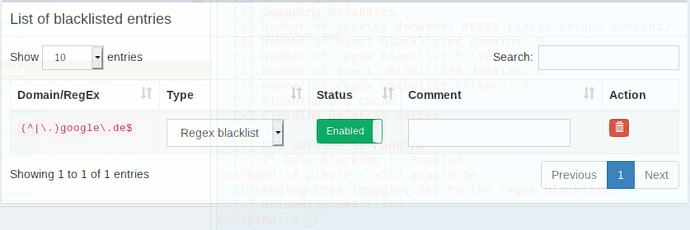

I did a test:
sudo service pihole-FTL stop
sudo sqlite3 /etc/pihole/gravity.db "delete from gravity where domain like '%.google.de';"
sudo service pihole-FTL start
Look here:
It's not removed via command above.
sqlite3 does not work to delete google.de from Pi-Hole database.
