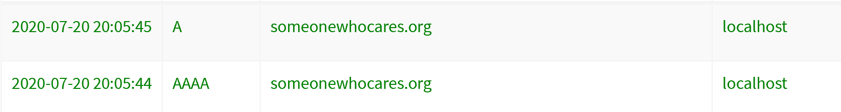

I'm not clear on what the web interface screenshot is in reference to, can you explain what that was meant to show?

The screenshot is just there to show the pi, and thus the script, executed by cron, is using pihole-FTL as a resolver.
