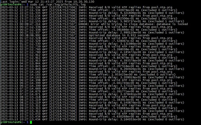

Error appearing in Pihole web interface does not appear in FTL.log

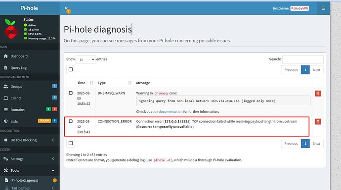

An error appearing on the Pihole Web interface, to appear in sequence within the FTL.log
There is no entry with same timestamp in the FTL.log; Note that Web shows local time which is GMT+2
Possibly the error entries have been deleted from the log file. It is unclear to me what triggers this log to purge its contents.

Pi-hole diagnosis would aggregate information from many sources, not just FTL.log.
That connection error would be in pihole.log.
The diagnosis log also only shows one instance of a repeated warning. You may just be seeing the first time it happened.
Yeah, I got that. But what triggers the FTL.log being purged. It was less than 12hrs that I checked and the data was gone, whereas other times I reckon it keeps data for days.
It's likely not being purged. It's a linux feature called logrotate that archives log files after a configured amount of time in order to not run out of disk space.
If you run ls -la /var/log/pihole you should see a lot of compressed files with the same names. These are the old logs.
The logs rotate per a rotation schedule installed by Pi-hole. Nightly at midnight.
