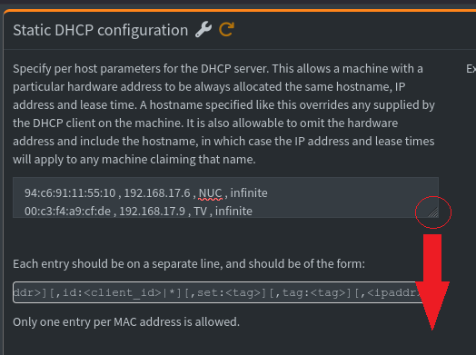

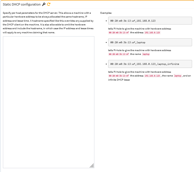

On the page where I set static IP addresses - this one:
Why is the list of STATIC addresses SO SMALL?
Although I can drag the window (bottom right corner) it expands to..... not much more.
Is that correct?

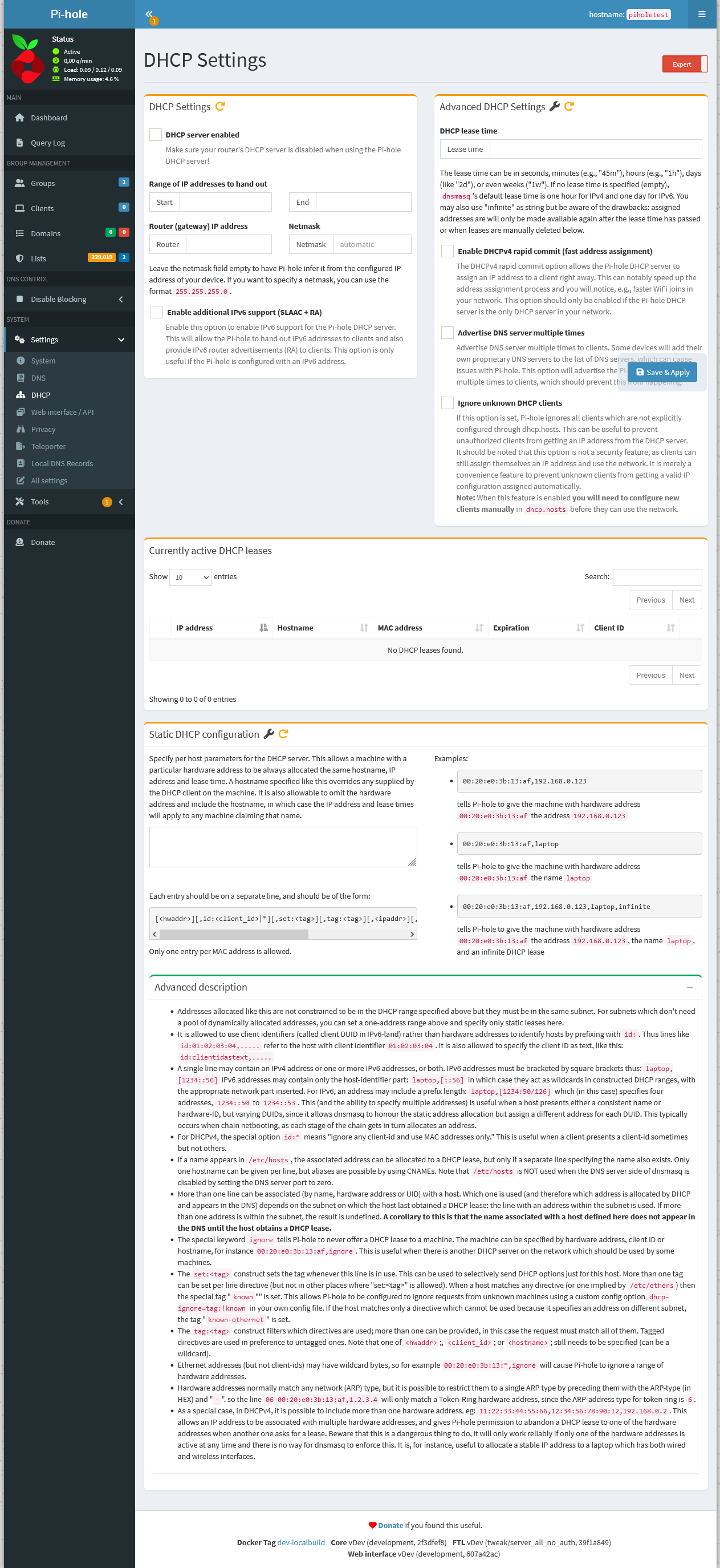

This is how the page looks like:
Can you see the page footer?
If you can't, your browser is not correctly rendering the page. Check for error messages on the browser Console (devtools).

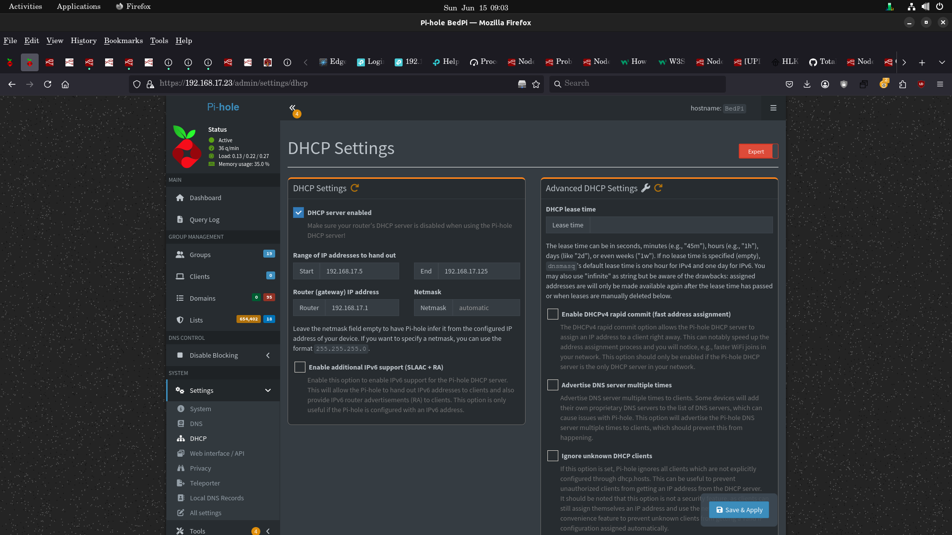

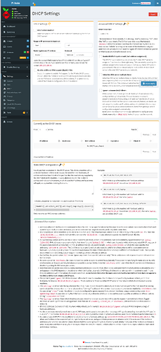

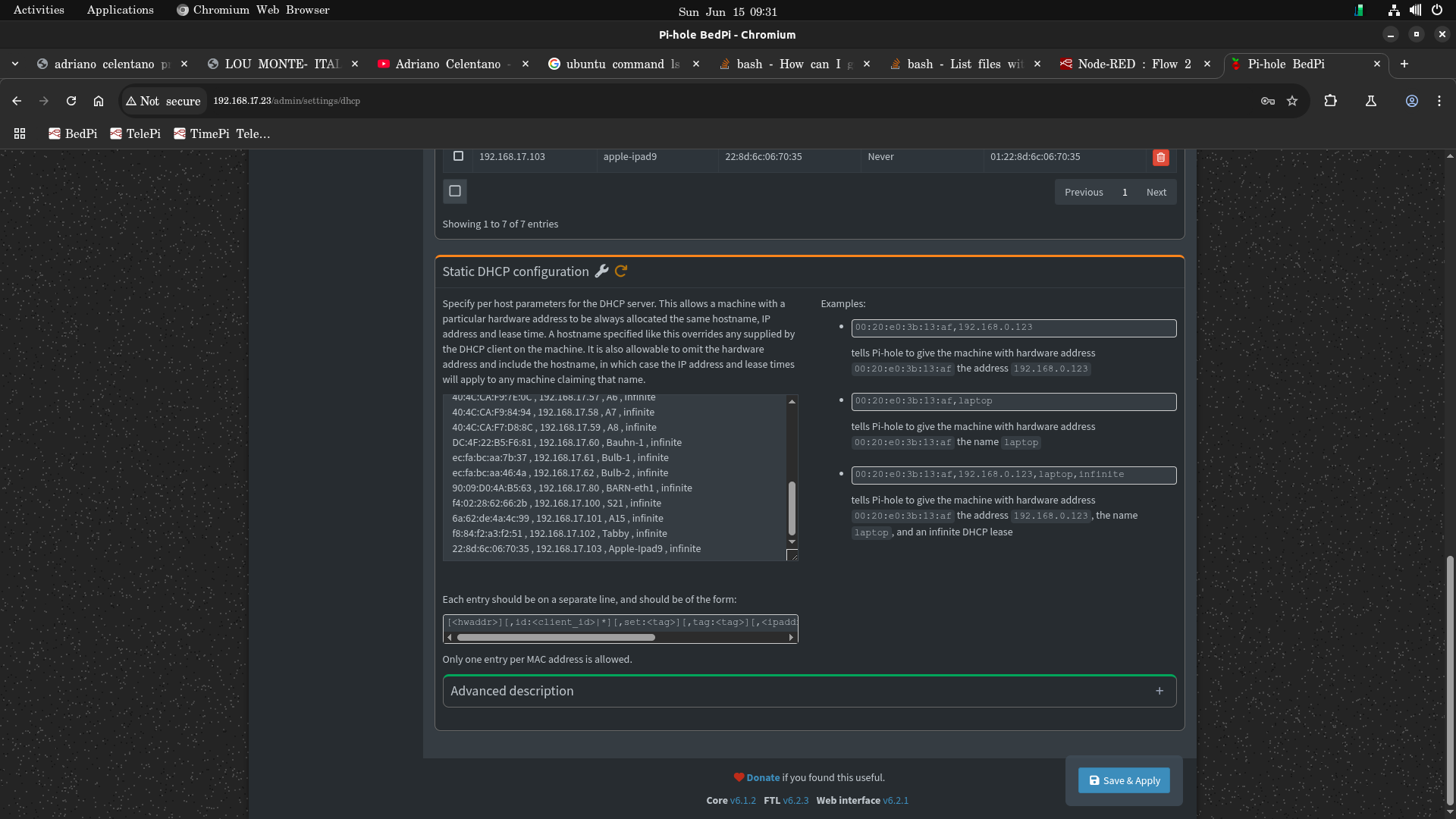

This is what I see in Pihole - though the screen does scroll off the bottom.
Most of what you have on/in your screen shot I have in mine.
Just the layout is different.
I am viewing EXPERT settings but the window where I enter the static IP addresses only stretches to a slightly bigger window.
Try a different browser.

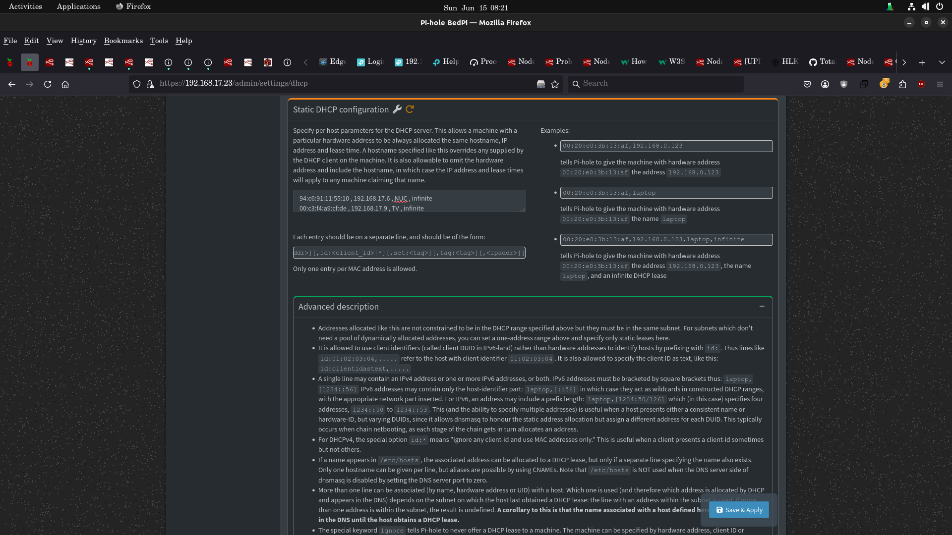

Try to drag the textarea corner to expend it:
Opera - different browser.
Same problem.
Just the window sizer looks a bit different.
Can NOT make it wider, and that is the longest I can make it.

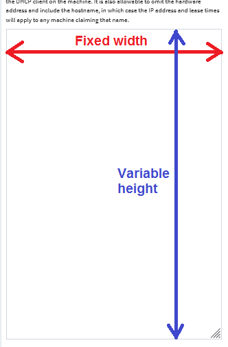

This is expected, you can only change the height.
I'm also using Firefox and I can resize it as much as I want:

Both sentences are correct:
  • you can change the height as much as you like (you can make the textarea taller).
  • you can't change the width (you can't make the textarea wider).
