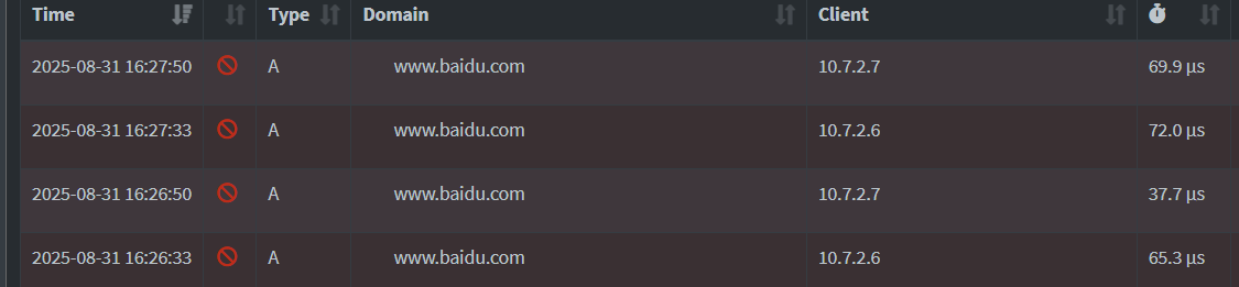

Stop IoT devices from ‘phoning home’ all the time - swamping pihole query logs with ‘baidu.com’
My IoT devices don’t have a manual way of setting a DNS, so they naturally pick up pihole DNS IP’s (from DHCP) - but they’re spamming pihole because they try and contact baidu.com every minute or so. I was wondering if there is a way to stop such records from appearing in the query logs within pihole (v6.1.4)
Baidu.com is being contacted every minute or so by my Lubluelu robot vacuums.
Replace this text with the debug token provided from running pihole -d
Expert mode / All settings / webserver.api.excludeDomain
^*\baidu\.com$
Expert mode / All settings / webserver.api.excludeClients
^10\.7\.2\.7$
^10\.7\.2\.6$
Thanks Smurf. So I guess the first regex excludes the domains from showing in the queries and the second one would exclude the entire device?
I had to tweak the regex a little, but this worked:
Thanks for your help.
