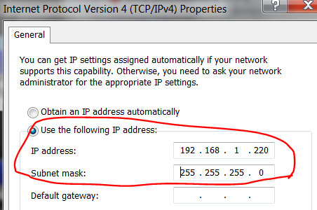

On the laptop, change network settings from automatically acquiring IP details through DHCP into a static one:
And connect the ethernet cable connected to Pi-hole directly to the laptop without the router in between.
And run nslookups.
