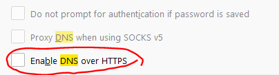

Wow amazing.
Makes you wonder who/what decides.
EDIT: just checked Debian laptop and is same.
You have to opt-in.
I have Firefox 73.0.1 on MacOS and the default is OFF.

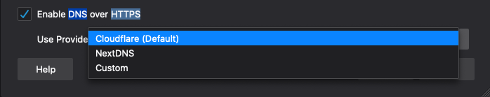

As you can choose a provider of DNS over HTTPS, I do wonder if this could be my pi-hole in the future... anyone can tell me if this is, or is not possible?
What would be the purpose or benefit of encrypting local DNS traffic on your LAN?
not so much indeed. But one thing could be that I want to make sure that Firefox uses the DNS I specify and doesn't change without me noticing it.
As discussed in this thread, people are not sure that the settings of their browser might not change with an update.
If your browser does not honor your networks DNS settings and chooses to contact DNS servers of its choice instead, the only instance where you could control this is your very browser.
This is entirely independent from the protocol being employed, and there is absolutely nothing that Pi-hole could do about it.
If you'd want to control that possible misbehaviour at network level, you'd have to introduce a DPI firewall at the gateway or on the device where your browser lives to selectively block port 443 requests and quite possible have to break the connections encryption as well (not very feasible).
and that is exactly what this is about... Firefox changing DNS to Cloudflare without informing the user is a problem.
I hope that there are better/easier/fairer solutions then the one you propose.

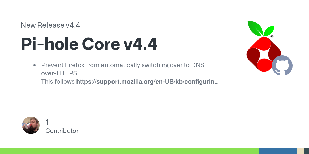

This is the default setting n the currently released version of Pi-hole.
Latest stable v4:
pi@noads:~ $ tail -1 /etc/dnsmasq.d/01-pihole.conf
server=/use-application-dns.net/
Beta v5:
pi@phb5:~ $ tail -1 /etc/dnsmasq.d/01-pihole.conf
Is there an issue with the currently shipping versions?
Not that I know of if your asking me.
That added directive is doing exactly whats expected.

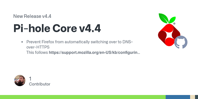

This has already been posted here, but I think this will make it easier to spot as a solution.
For all that are still wondering how to easily stop Firefox from working around pi-hole and using its own doh magic, there is an easy solution.
Just have your pi-hole block this url: use-application-dns.net
Firefox is checking if it can reach use-application-dns.net upon startup and will turn off all doh features if the result is negative.
For further reading: https://support.mozilla.org/en-US/kb/canary-domain-use-application-dnsnet
This has been incorporated in Pi-hole since Feb 2020, in Version 4.4.
The configuration option can be toggled in the FTL configuration file:
