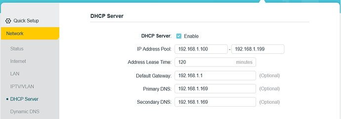

Where are you changing this?
On the WAN/Internet settings? Or on the DHCP/LAN/Network settings?
In the Advanced>Network>Internet section of the router configuration (currently set to the Google DNS servers)
If your router interface is similar to the one on the online emulator, you should try to change the DNS setting on the "DHCP server" page:

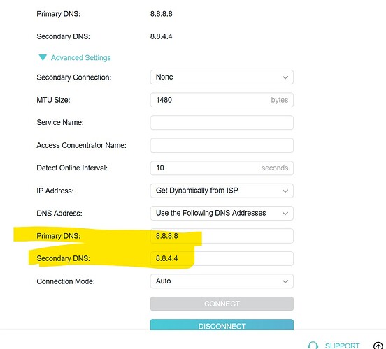

The DNS server on the "Internet" page can be set to the default values, or any other public servers, like 8.8.8.8.
OK. I will try that.
The Internet configuration page needs to have an address in the Primary DNS field. Do I leave at 8.8.8.8 (or other DNS provider)?
Yes.
  • Select the "Use the Following DNS Addresses" and type any public DNS server you like
or
  • use the "Get Dynamically from ISP" and use the servers provided by your ISP.
Brilliant!
Thanks for the help......told you that i was crap at this stuff!
