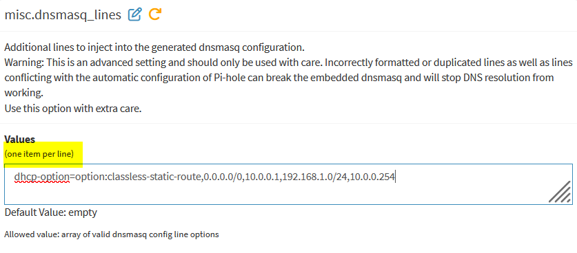

Last time I checked, if want to push a static route, you also have to push the default route/gateway via this option.
Suppose my Internet router sits at 10.0.0.1, and I want to push a static route to 192.168.1.0/24 via 10.0.0.254, that directive would need to look like below:
dhcp-option=option:classless-static-route,0.0.0.0/0,10.0.0.1,192.168.1.0/24,10.0.0.254
You can enter that via the webGUI Expert --> All settings --> Miscellaneous below:
And oc a client would first need to renew its DHCP lease for the new route to propagate.
