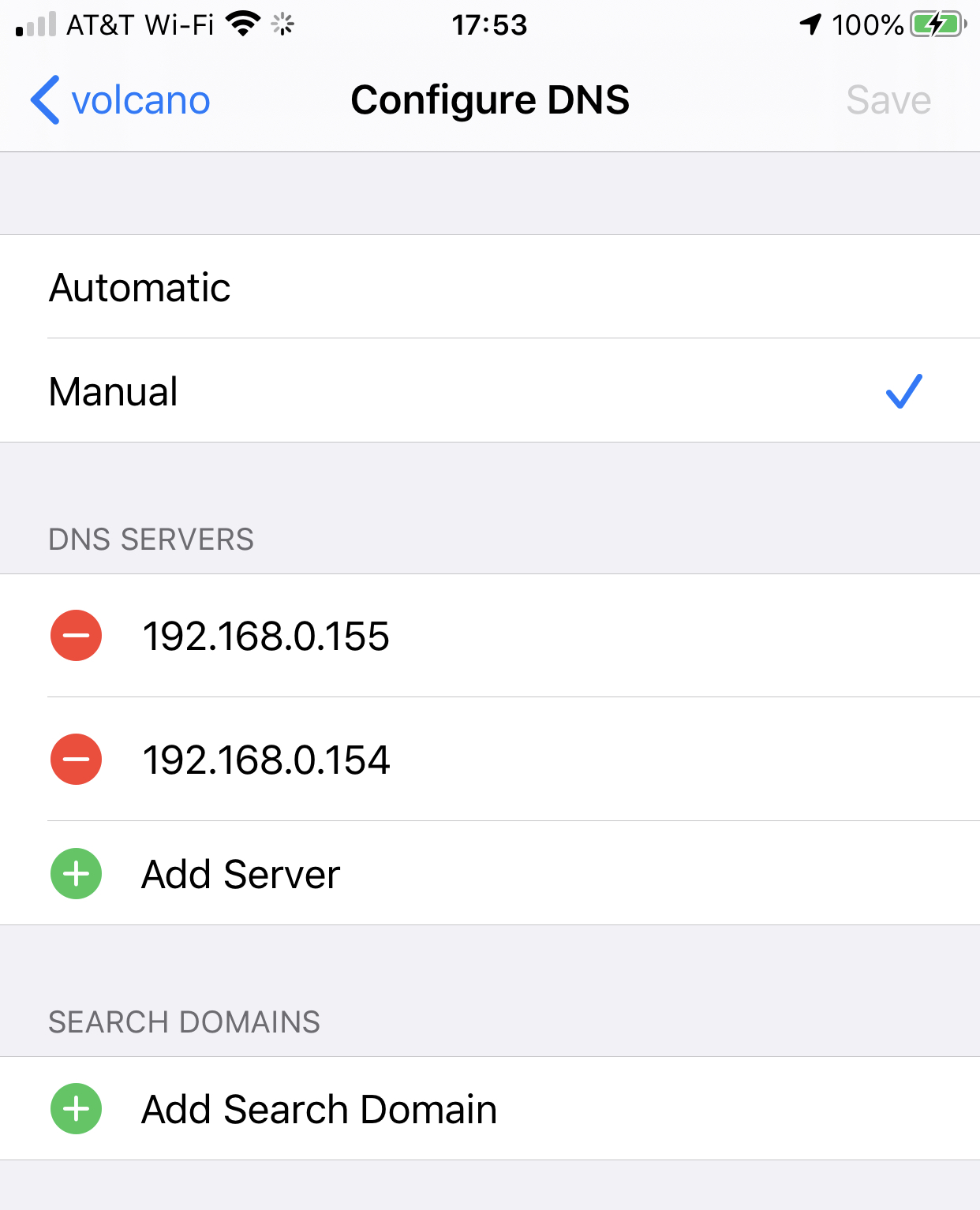

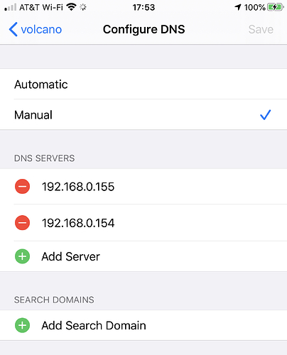

Good point - are you running any additional WiFi equipment like an AP or repeater?
What DNS servers are shown in settings > WiFi > DNS?
Should look like this - this example has two Pi-Holes in parallel.

It has the ip of the pi-hole which is 192.168.1.154
Tail the Pi-Hole log while loading a web page from that device. Do you see queries from that device?
Does the device have an IPv6 address or IPV6 DNS server listed?
