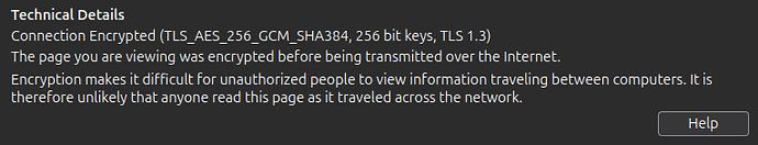

When I no go ahead and run
sudo pihole-FTL --config webserver.advancedOpts '["ssl_cipher_list=TLS1-3-AES-256-GCM-SHA384"]'
I get this in my Firefox:

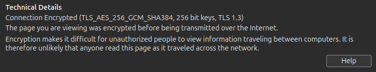

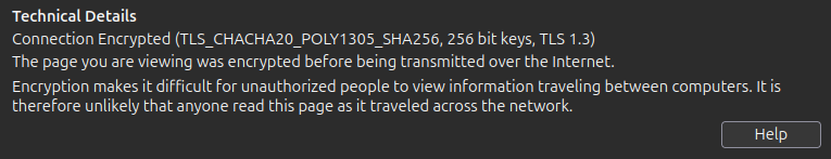

or
sudo pihole-FTL --config webserver.advancedOpts '["ssl_cipher_list=TLS1-3-CHACHA20-POLY1305-SHA256"]'
This sets the list of allowed ciphersuites and the preference order (comma-separated strings). First in the list means the highest preference. The list of ciphersuites passed to this config option may contain a mixture of TLS 1.2 and TLS 1.3 ciphersuite identifiers. This is useful if negotiation of TLS 1.3 should be attempted, but a fallback to TLS 1.2 would be tolerated.

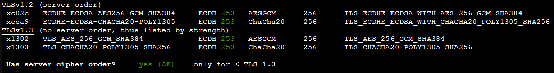

The order should work, see the comment here:
I am not sure how to read/interpret your screenshot but if it does not work, one might need to file a mbedtls bug report...
Honestly I don’t view it as enough of an issue, although I also accept that such an approach would also lead to bugs never being fixed in the first place. Suspect the ordering is coming from somewhere else but cannot prove it. For reference, I am using testssl to scan: testssl/testssl.sh: Testing TLS/SSL encryption anywhere on any port
The snip shows the order in which ciphers will be selected, hence the statement for 1.3 saying no order received. I have seen this before with OpenSSL, hence why I say it may be coming from elsewhere.

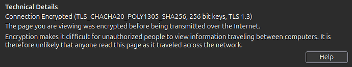

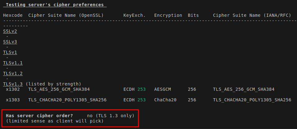

And with
sudo pihole-FTL --config webserver.advancedOpts '["ssl_cipher_list=TLS1-3-CHACHA20-POLY1305-SHA256,TLS1-3-AES-256-GCM-SHA384"]'
we furthermore get:
