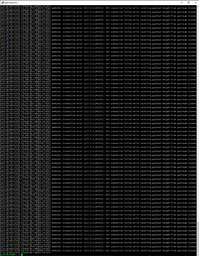

Connection error (127.0.0.1#5335): TCP connection failed while receiving payload length from upstream (Connection prematurely closed by remote server)
One new occurence appears on Pihole web interface but unable to verify the number of incidents in the FTL.log (unsure what triggers this log to purge itself)

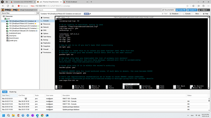

I have the below entries in unbound.conf.d/pi-hole.conf
Currently I haven't seen any errors.
server:
    # This setting should increase the number of TCP connections that stop the pi-hole errors
    incoming-num-tcp: 50
    tcp-idle-timeout: 1024
    outgoing-range: 8192
    num-queries-per-thread: 4096
    # If no logfile is specified, syslog is used
    logfile: "/var/log/unbound/unbound.log"
    log-time-ascii: yes
    log-queries: yes
    log-replies: yes
    verbosity: 0
In my setup, the /etc/unbound/unbound.conf has a single include statement
include-toplevel: "/etc/unbound/unbound.conf.d/*.conf", whereas the configuration is in /etc/unbound/unbound.conf.d/pi-hole.conf. I assume your suggested modifications should be on this conf file on my setup; correct?
Oops :slight_smile: post updated
Thanks for the catch
/etc/unbound/unbound.conf.d/pi-hole.conf:    incoming-num-tcp: 50
/etc/unbound/unbound.conf.d/pi-hole.conf:    tcp-idle-timeout: 1024
/etc/unbound/unbound.conf.d/pi-hole.conf:    outgoing-range: 8192
/etc/unbound/unbound.conf.d/pi-hole.conf:    num-queries-per-thread: 4096
/etc/unbound/unbound.conf.d/pi-hole.conf:    logfile: "/var/log/unbound/unbound.log"
/etc/unbound/unbound.conf.d/pi-hole.conf:    log-time-ascii: yes
/etc/unbound/unbound.conf.d/pi-hole.conf:    log-queries: yes
/etc/unbound/unbound.conf.d/pi-hole.conf:    log-replies: yes
/etc/unbound/unbound.conf.d/pi-hole.conf:    verbosity: 0

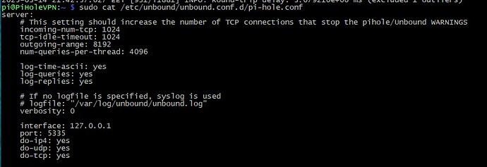

It did not go well with my setup. I have had multiple intermittent occurences of the error since making these modifications to the /etc/unbound/unbound.conf.d/pi-hole.conf file. I reverted "incoming-num-tcp" to 1024 and monitoring.
It is strange...
I got two instances of pi-hole, one on Wired LAN and the other on Wireless LAN, on the wireless LAN I almost never see the issue, while on the wired LAN I see the error, just since the change I did I haven't seen one instance on either of the two pi-hole instances.
Initial I had the idea it was browser related, but not...
Check https://github.com/NLnetLabs/unbound/issues/1237#issuecomment-2658989107 where we opened the issue with the unbound team.
This is the top lines of my /etc/unbound/unbound.conf.d/pi-hole.conf:
I have had 3 occurences since my last modification to the conf file
