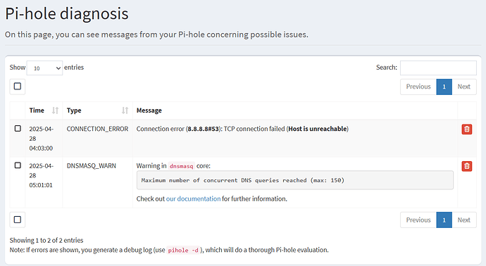

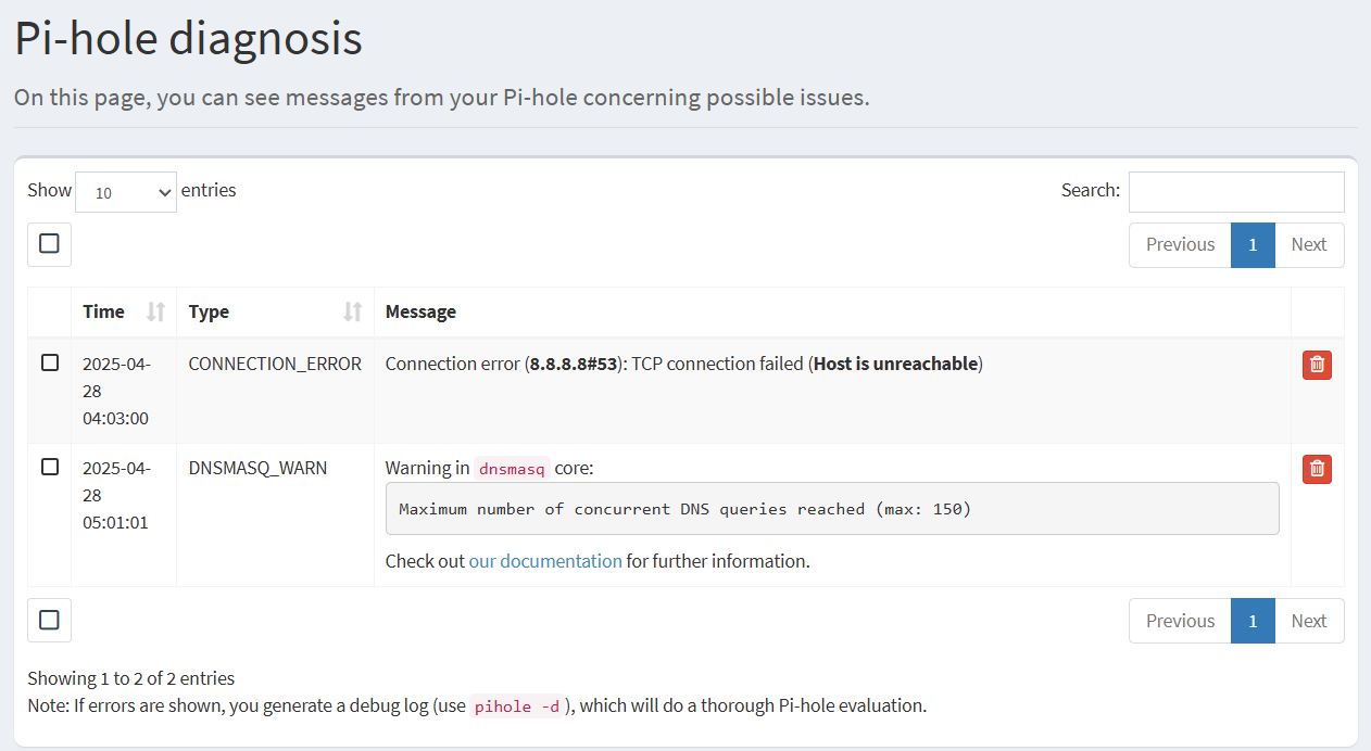

Im also getting this in the log
any ideas? :pleading_face:
