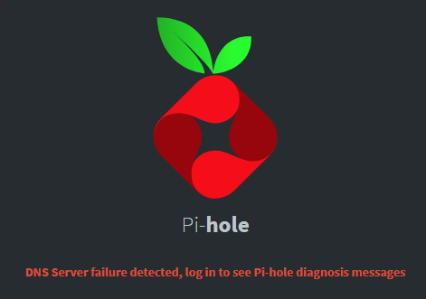

I put your pcap command in both my containers and now both are broken and not resolving DNS at all. Looks like that changed the ftl config to point to the pcap file? How can I quickly correct this without losing my configurations?
Logging into the IP:8080 web interface and removing the writable pcap variable in the All Settings Expert brought back resolution. I would hope writing a pcap file would mirror the traffic to an output and not take over the interface. I do not believe I'll be able to capture a pcap of this behavior given my environment.

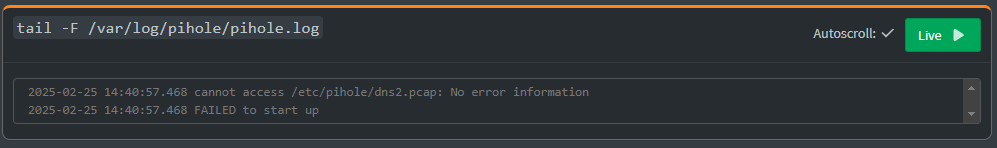

I touched a file to my /pihole mapped config folder and performed chmod 777 inside the container on the touched pcap file. Once I put the command in to write to the .pcap (or placing it directly in the file field in the GUI), I get the following message on the dashboard:
FLSLog entry:
2025-02-25 14:45:48.283 CRIT Error in dnsmasq configuration: cannot access /etc/pihole/dns2.pcap: No error information
Local File Structure:
pihole:/# touch /etc/pihole/dns2.pcap
pihole:/# chmod 777 /etc/pihole/dns2.pcap
pihole:/# ls -l /etc/pihole/dns2.pcap
-rwxrwxrwx 1 root pihole 0 Feb 25 14:40 /etc/pihole/dns2.pcap
pihole:/# pihole-FTL --config files.pcap /etc/pihole/dns2.pcap
