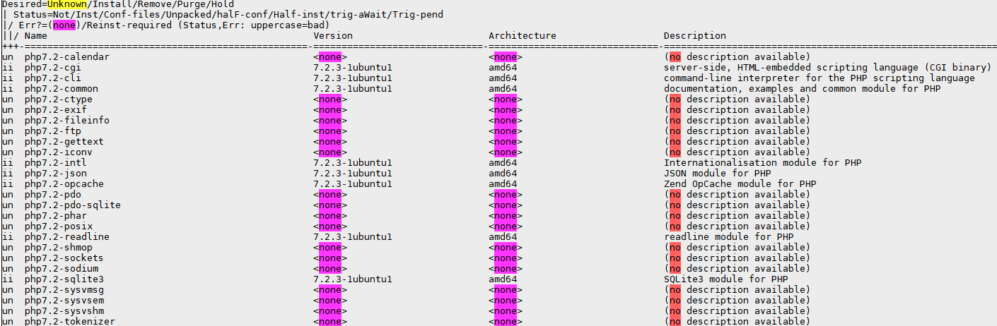

Can you print:
dpkg --print-architecture
dpkg --print-foreign-architectures
dpkg -l 'php7.2-*'
amd64

Okay I justed checked the package lists for PHP common (in main) and intl (in universe) in default archive and security repo:
All of them contain the PHP 7.2.3 packages without exception, no 7.2.24 version at all!
The same time the package pools of all those repos contain the PHP 7.2.24 packages as well (beside the 7.2.3 ones) by filename for bionic 18.04, matching the php7.2-common version that is about to be pulled as above user posts:
I can only imagine that Ubuntu released the new version and then reverted the change due to issues, or such. And now local package lists or cache might contain inconsistent data.
