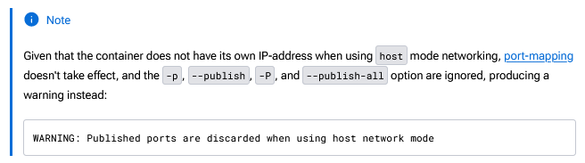

Note:
In host mode ports are ignored and you should remove them from your command.
From docker docs:
