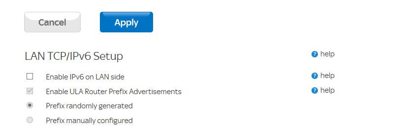

IPV6 is disabled at my isp provided router, as here
And so the link you mention returns IPV6 as not supported.
This was how i had it set before upgrading to Pi-hole v5
