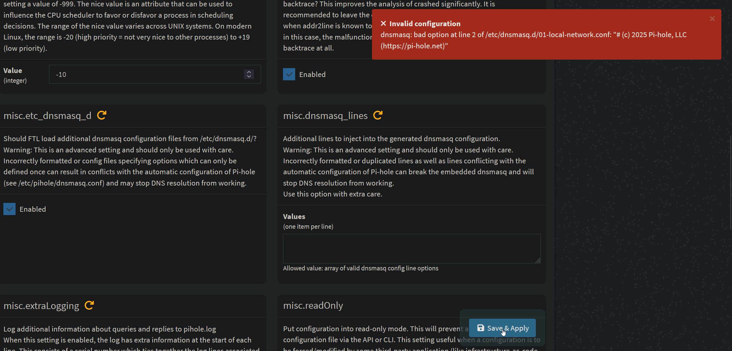

Cannot enable /etc/dnsmasq.d
Records in the /etc/dnsmasq.d folder are loaded into the resolver after enabling the misc.etc_dnsmasq_d setting in the “All Settings → Misc” tab.

After attempting to enable the misc.etc_dnsmasq_d and save, a red error box opens on the right top corner
Invalid configuration
dnsmasq: bad option at line 2 of /etc/dnsmasq.d/01-local-network.conf: "# (c) 2025 Pi-hole, LLC (https://pi-hole.net)"
There is no 01-local-network.conf file in my /etc/dnsmasq.d directory to have a “bad option” in.

That was the reason I opened this ticket. I cannot enable it, at least not via the Web UI.
I will look at the DHCP settings, but I don't think that is related to the issue, though I could be wrong. The intent is that my router (10.100.0.1) is my only DHCP server. I also have set up, and it is likely overkill, PiHole on three "servers" on my network. A VM on each of my ProxMox servers (used to be one LXC and one VM on the same proxmox) and one Raspberry Pi. One VM is the primary DNS (10.100.0.12) and was the primary before the LXC was decommissioned. The former LXC and the Raspberry Pi have Keepalived running a VIP between them. They are 10.100.0.10 and 10.100.0.11 (10 used to be primary before the LXC developed issues). The VIP assigned in 10.100.0.9 and is set to be secondary DNS. All three are running unbound on their own system and have the loopback port set to be the upstream dns on port 5353. I share the config amongst the servers using nebula sync.
The log I uploaded was from 10.100.0.12. It won't let me set the dnsmasq setting in the web UI.
For some reason, when I went to look at my local records config the other day, all my values were gone and were now listed in the "hosts" section of my pihole.toml. I wanted to add a new one (my octoprint VM) but when I try to add it, it wasn't in the resolve lists. I wanted to centralize things, so I made an ansible script that would append to a 99-ansible-hosts.conf in the dnsmasq.d folder. It is not reading in the dnsmasq.d because of the setting I cannot change in the webui. I assume I can edit the pihole.toml, but I don't know why the error is reporting back a file that doesn't exist in my dnsmasq.d directory at all.

It was all a big mistake on my part. I was migrating some of my servers around and thought my changes to make dns and dns3 on my network swap places. So when I was logged into what my primary via SSH where I was working on the dnsmasq settings, the UI was pointed to my dns3 server. The UI said it was the primary, but that was a cross configure issue where I didn't update the resolution. I got everything figured out and it is all running cleanly now.
