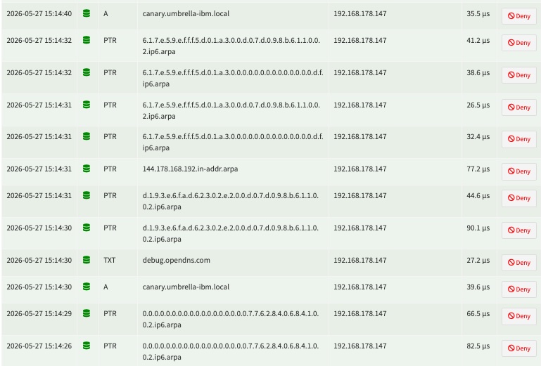

How do the latter two register in Pi-hole's Query Log?

Your nslookup for test.mywire.org didn't register in Pi-hole's Query Log, i.e. respective DNS requests never made it to Pi-hole.
This demonstrates that the reply of 208.67.222.111 was not supplied by Pi-hole, but an alternative DNS server.
Similar is true for the FTL version lookup:
No TXT record request registers in Pi-hole's Query Log, i.e. it was the alternative DNS server that REFUSED to answer.
Something in your network (or on the machine you've run those nslookups from) is intercepting and redirecting DNS requests to another DNS server.
The usual suspects would be your router's firewall, or a personal firewall or antivirus feature on the machine issuing those nslookups.

It seems Cisco Umbrella DNS is running as a system service on my Mac (company policy) and intercepting DNS queries. Thanks for the support Bucking_Horn, nero355
