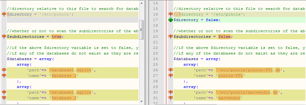

While I was configuring lighttpd to use TMPFS, I noticed some error messages in /var/log/lighttpd/error.log:
(mod_fastcgi.c.2543) FastCGI-stderr: PHP Warning: file_get_contents(/etc/pihole/list.41.someonewhocares.org.domains): failed to open stream: Permission denied in /var/www/html/phpliteadmin.php on line 769
Here is a notepad++ screenshot, with the modifications, left side is the result from the original post, right side is the corrected version, that eliminates the errors.
The downside of eliminating the errors: If pihole introduces a new database, you will NOT see it unless you update the database array.
