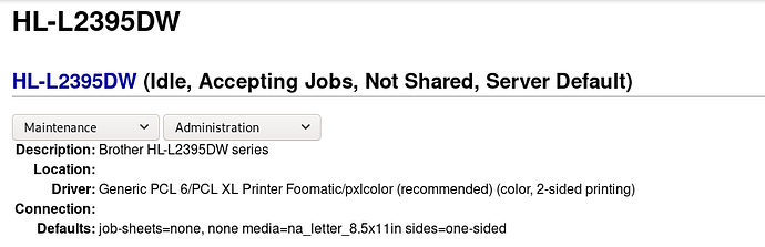

So I tried uninstalling all of the Brother software and it's actually still being queried in Pi-hole. Weird. I thought for sure it was the software doing it.

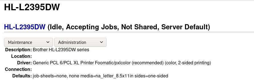

The name "brw0c" seems to be related to Brother:
https://ask.fedoraproject.org/t/printer-either-takes-5-60-minutes-to-process-or-doesnt-print-at-all/3152/18
Yeah, I mentioned a few times it's a Brother printer. Mine prints right away, though.
