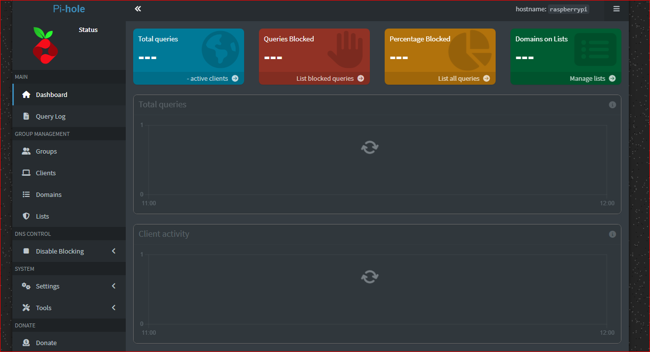

I noticed the eth0 thing, as it scrolled on by, but, it is working as I just connected via the web interface. However, the dashboard is just "churning".

Still having the issue. Below is what I see when Pihole stops responding. Just a minute ago saw a fully populated and active screen with eth0 being the port in use.
