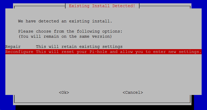

Above shows the Pi has IP 10.1.1.240 configured on the wlan0 (WiFi) network interface.
Above shows Pi-hole is configured to be used for the eth0 network interface.
But according to ip a, this eth0 interface is not connected "NO-CARRIER" and is not configured with an IP address:
Try run below one, select reconfigure, and when asked for the interfaces, select the wlan0 interface or both:
pihole -r
Afterwards, test again with the nslookup command on Pi:
nslookup pi.hole localhost
nslookup pi.hole 10.1.1.240
And on the client:
I was beginning to think that might be where the problem lay...as when I ran pihole -r the first time it gave me an option of eth0 or wlan0 and the default was eth0 - which I choose without thinking and this Rpi 3b+ is connected wirelessly to the router. So the problem is that when I run pihole -r again it does not give me a choice of interfaces anymore...as it has baked in the first choice!....so I need to get pihole -r to do a fresh run. How would I do that. Thank you for your time and help, I really appreciate it.
You need to select "Reconfigure":
Ah! of course...thank you!
