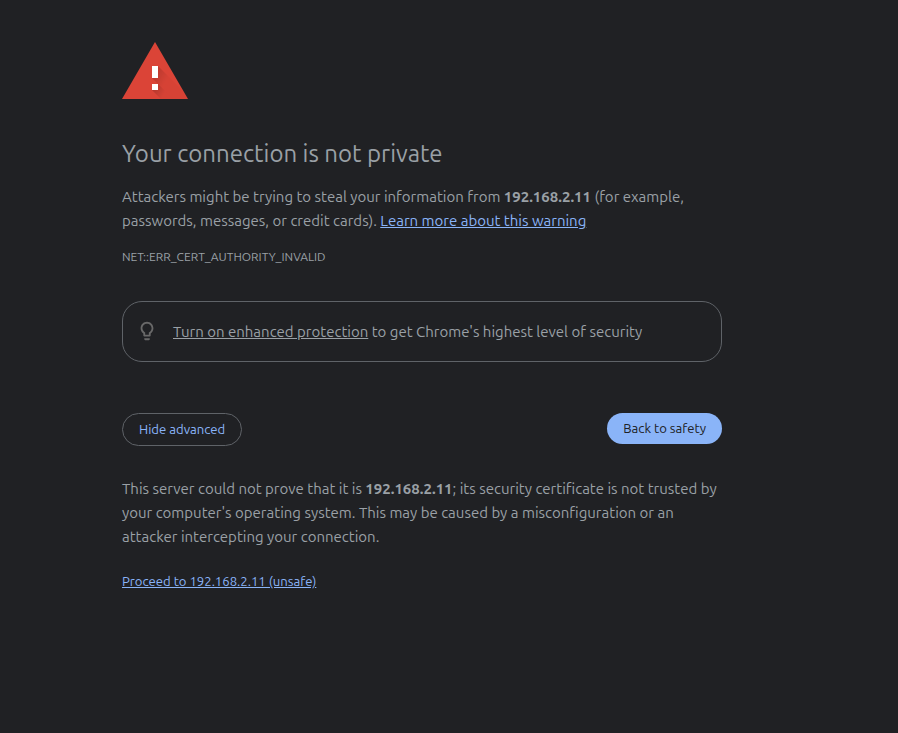

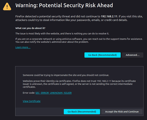

The proposed validity range is reduced from 30 to 2 years in here, but this is not set in stone. I'd like to foster a discussion here for what you think is needed.
Note: Short lifetimes may cause some inconvenience to users. Whenever the certificate is automatically regenerated, users will again have to confirm that they want the browser to trust the new certificate:
(Chromium)
(Firefox)
