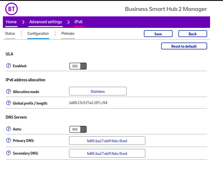

No, that didn't work.
If it would, your router's link-local should have vanished from resolvectl status output.

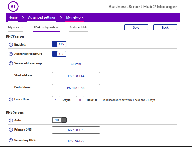

Could you share a screenshot of your router's configuration screen for those IPv6 addresses?
I meant that pi.hole/admin still resolves.
Screenshots of IPv4 and IPv6 router config pages attached.
I think so yes. My router is still the DHCP server

Your v6 pihole -FTL did solicit above router advertisement (RA) from your router, and it correctly shows your Pi-hole's LLA ending in ed in both slots.
But your client is a still aware of your router's LLA, ending in d6:
This could be a leftover from a previous RA.
Please monitor if that would vanish within the next 5 minutes (the longest lifetime from the RA, at 300 seconds).
Still there after an hour.
