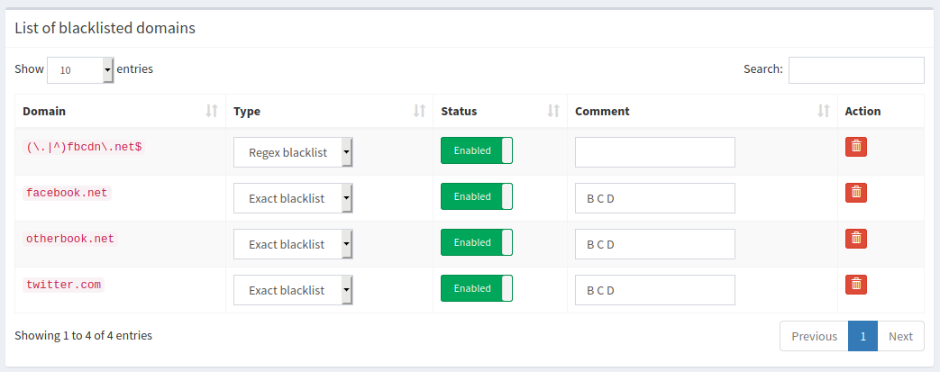

Feel free to test it using
pihole checkout core new/CLI_domain_comments
You can use
pihole -b --comment "A B C" facebook.net
or even
pihole -b facebook.net --comment "A B C"
Multiple domain can still be added
pihole -b --comment "A B C" facebook.net otherbook.net twitter.com
When you specify the --comment option multiple times, we use the last comment, e.g.,
pihole -b --comment "A B C" facebook.net otherbook.net --comment "B C D" twitter.com
will add the three domains with the comment B C D:
