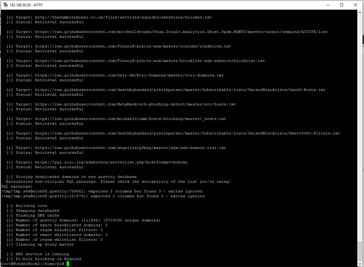

so question would a list like this work with pihole i disabled it till i can hit the list that is causing issues, not sure if this is too much of a mess.
https://raw.githubusercontent.com/lewisje/jansal/master/adblock/hosts
No it won't work. curl it yourself to see.
Go back to the stock list setup. Add back the lists you want one at a time until you see issues. If that is a long process then honestly it should be. Adding 70+ lists that no one knows the status of is just a bad idea.

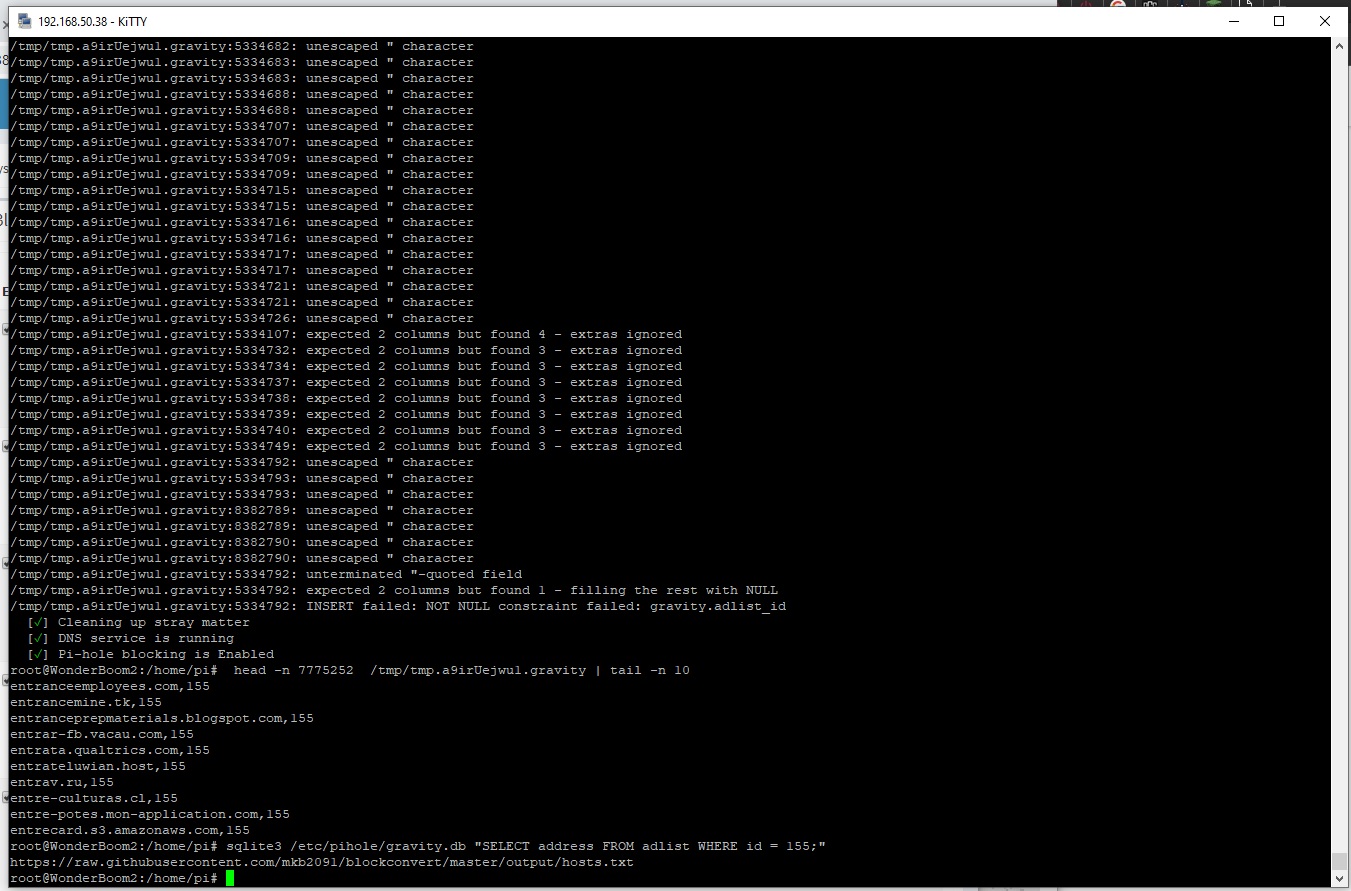

from this list i think its the culprit, probably needs parsing logic to remove the ;1, i found it duplicated oddly
https://joewein.net/dl/bl/dom-bl-base.txt
according to your commands this is the list, i just doing a gravity with it disabled
https://raw.githubusercontent.com/mkb2091/blockconvert/master/output/hosts.txt
root@WonderBoom2:/home/pi# head -n 7775252 /tmp/tmp.a9irUejwu1.gravity | tail -n 10

And after 5.0 is released they will find that the lists they were using and were happy with didn't really do anything in Pi-hole v4, adding extra lists doesn't do much of anything. They will learn that the lists they use are not proper and need to be fixed or no longer used. I do not think that manipulating lists and filtering out garbage is the proper response. That is a band-aid response.
I'll be blunt. You're using garbage lists and lists that are not compatible with Pi-hole. Stop chasing insane numbers of blocked domains and look at the user experience. Start with the default lists and if you see ads then that is the time to add more lists.
