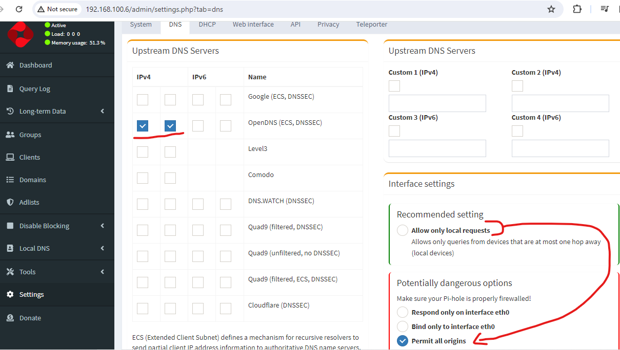

2 - DNS resolv: - As i searched on the internet and here, some people said to change local host dns nameserver 127.0.0.53 to any preferred DNS upstream, I changed it to google dns on my file resolv.conf
3 - The problem:
All this changes, is to try to solve WiFi connections, which I looked for a solution here on the Forum. One of this topic I found this: Go to Settings >> DNS >> and on the option Potentially dangerous option I checked Permit all origins. As said in the documentation, marking this option is dangerous. But if didn't do this, I can't access the internet on my WiFi network, laptops and mobiles.

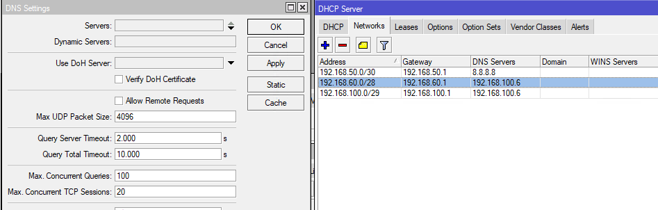

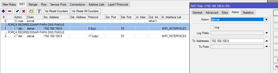

4 - My router Mikrotik get IP address from my ISP by DHCP Client
5 - DHCP Server >> Network >> DNS Server pointing to PI-HOLE server.
6 - NAT >> DSTNAT>>redirecting to PI-HOLE server any query from my wifi network, the propose here is, If a user change their preferred dns on the laptop, it would redirect any dns query on port 53 to the pi-hole.
But, If I change to recommended Setting on Settings >> DNS I cannot access internet, I should really left this option as dangerous, Permit All origin, so just this way I can connect mobiles and laptops through the internet ?

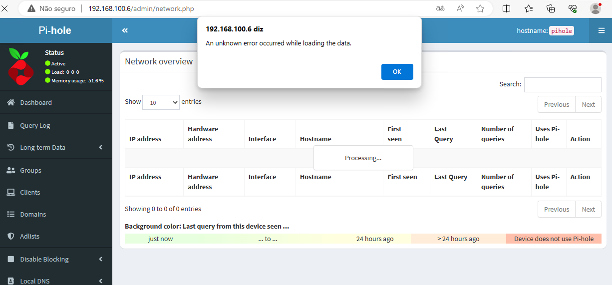

7 - Last one - Dashboard Total Queries
when I click here, something wrong happens. It says an unknow error occurred while locating the data, I think I made a mistake, but I don't know how

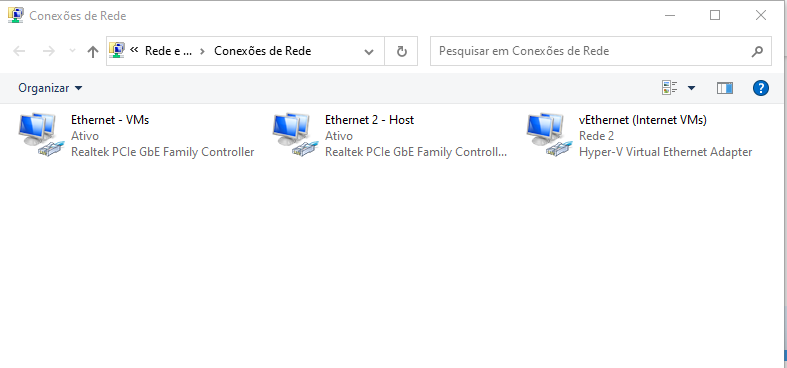

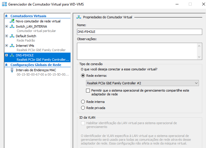

The pi-hole server is on a virtual machine on Hyper-V. I dedicated one phisical interface Ethernet 2 to the pi-hole.

This log was captured using the settings DNS >> Interface setting >> permit all origin. There're some queries on the log and I changed the resolv.conf too. And I try again click on dashboard Total Queries it brings me back the same error, this is because am I using pi-hole virtulized o hyper-v or version of the Ubuntu Server.
I gonna do another log upload later, using the configuration recommended in DNS >> Recommended setting "Allow only local requests"

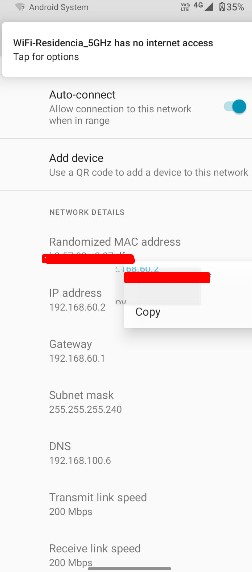

mobile says no connection when try to connect to the wifi network
Your both debug logs show an issue with your database (the database is corrupted and missing some tables and fields), so let's start fixing this.
Run these commands to move the existing database to a new file name and create a fresh database.
sudo service pihole-FTL stop
sudo mv /etc/pihole/pihole-FTL.db /etc/pihole/pihole-FTL-old.db
sudo service pihole-FTL start

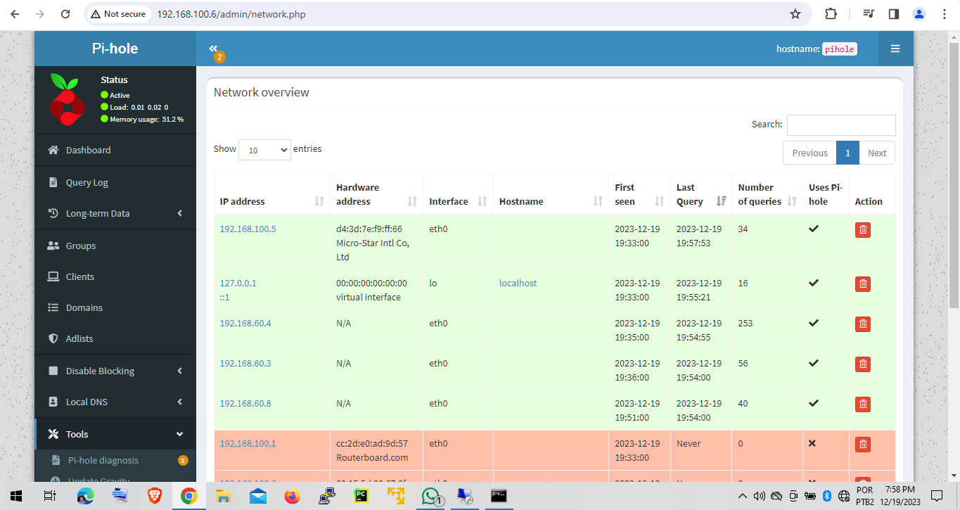

Okay, I just tested it and now I can see Network overview, perfectly.
But, still have a question about DNS query, because when I changed it to Allow only local requests, my devices connected to the WiFi network doesn't navigate to any page. Just my desktop connected to the cable, works. So I changed it back to Respond only on interface eth0 and I ask you, is this insecure option or any of these 3 ? because that options works fine both on my WiFi network and cabled on.
